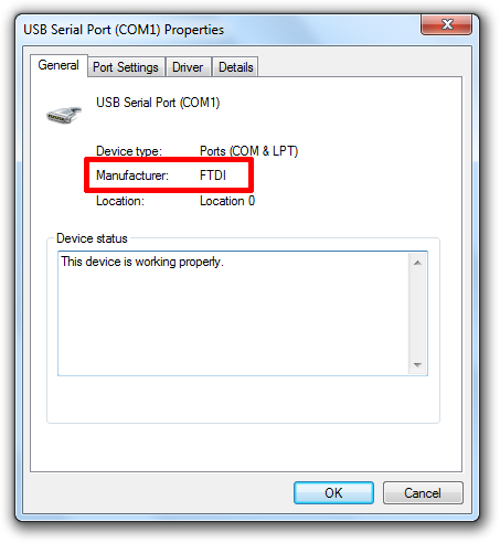

  1. Press the Windows (a.k.a. Start) button. Type device manager and press Enter.
  2. In Device Manager, expand Ports (COM & LPT) and select your serial port. The port number may not match what is shown here.
  3. Double-click the serial port and the USB Serial Port Properties dialog will appear. Go to the General tab and verify that the manufacturer is FTDI.
Instructions for Windows 7
Instructions for Windows XP
  1. Press the Start button and then click Control Panel.
  2. In Control Panel, double-click System.
  3. In the System Properties dialog, go to the Hardware tab and click Device Manager.
  4. In Device Manager, expand Ports (COM & LPT) and select your serial port. The port number may not match what is shown here.
  5. Double-click the serial port and the USB Serial Port Properties dialog will appear. Go to the General tab and verify that the manufacturer is FTDI.
